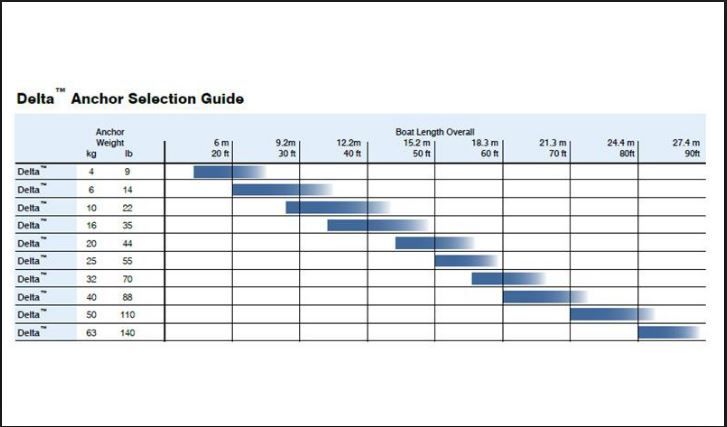

Interestingly the Delta anchor that we have doesn't fair too well when compared with others on the chart, yet we have never had a problem with it setting and holding in a variety of bottom conditions and sea conditions.
This could well be though because it is over sized for the boat, 10kg rather then the 6kg recommended, and we are also on all chain and tend to let out more scope then the minimum recommended amount.

Interestingly Lewmar suggest far smaller anchors for a given boat size/weight with their Delta anchors then the Ultra Anchor seem to recommend.
For our 25ft boat Delta suggest a 6kg anchor whereas the Ultra Anchor recommends closer to 10kg.
As it happens we are fitted with a 10kg Delta.
