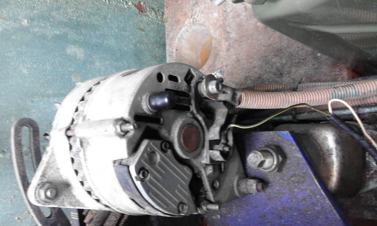

Just Heaven Posted May 29, 2016 Author Report Posted May 29, 2016 Without any meaningful info about the alternator it sound smor to me as if the alternator is batetry sensed any you have left the sense terminal off the battery (or just possibly put it on the wrong terminal). Tony Does this pic help?

Sir Nibble Posted May 29, 2016 Report Posted May 29, 2016 Tony Does this pic help? You need a regulator. That is the common or garden A127 alternator so you should find one off ebay. Simple to change, looks like yours would be simple with the alternator in situ. All you need to do to shut it down whilst you run off the other pro tem is to stick a wire from the warning light terminal to earth before starting the engine and leave it there. That alternator will then be just a belt tensioner until the link is removed.
Just Heaven Posted May 29, 2016 Author Report Posted May 29, 2016 Is the yellow/black wire the warning light terminal?
Just Heaven Posted May 29, 2016 Author Report Posted May 29, 2016 >That is the common or garden A127 alternator so you should find one off ebay We're currently cruising, so eBay isn't really an option. Also we have a deadline to get son-in-law back to work! I'll try and get one from a local motor factors.
Sir Nibble Posted May 29, 2016 Report Posted May 29, 2016 Is the yellow/black wire the warning light terminal?That's the one.
Just Heaven Posted May 29, 2016 Author Report Posted May 29, 2016 But presumably I need to disconnect the main terminal ?
Sir Nibble Posted May 29, 2016 Report Posted May 29, 2016 But presumably I need to disconnect the main terminal ?No, that link will harmlessly shut down the machine completely and the main terminal will be in the same state as if the engine wasn't running.

Just Heaven Posted May 29, 2016 Author Report Posted May 29, 2016 Did as advised by Sir Nibble. All ok so far, stable at 13.9 - 14.1
