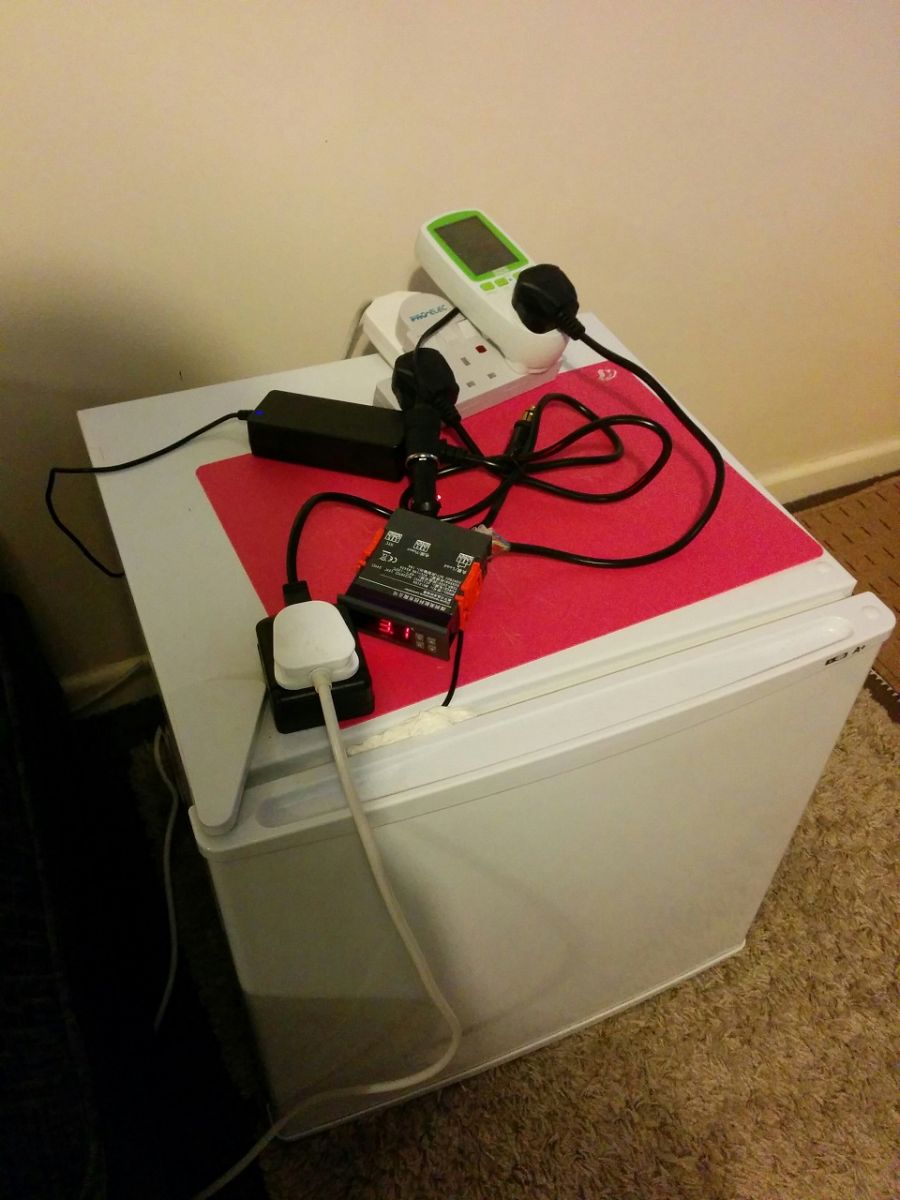

I’ve got an unmodified domestic mains freezer running as a fridge using an external temperature controller [which is easy to setup] to consume just 12-13AH per day including the Inverter and factoring inefficiencies.
Compared to my current Waeco CF-50, it uses around half its power in a day. Here’s how.
I took a LEC 32L counter-top freezer with thicker wall insulation than its fridge counterpart and hooked it up to a digital temperature control relay with a 10-Amp switch rating that runs off a separate 12v supply.
The temperature controller can cut the mains feed to the freezer via an inline AC socket and plug which goes between the Inverter’s output and the freezers AC cord.
It was setup to cut the delivered AC to the freezer every time the thermal probe [slipped through the door seal on a thin wire] dropped back to 4°C.
Observations showed it switched on the AC power feed when the temperature reached a steady 6°C.
The freezer would run for about 5 mins only around once per hour and cut the compressor at 4°C before the temperature bottomed-out at around 3°C.

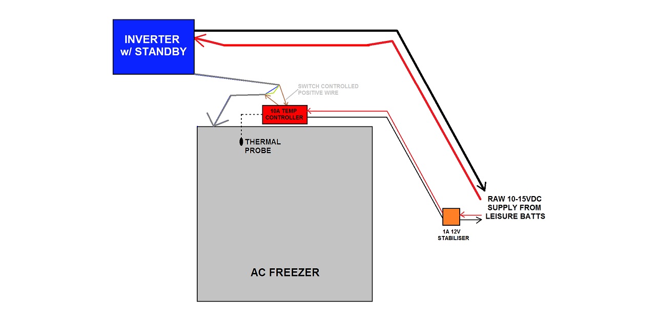

I plan to combine this freezer with a TBS Powersine PS600-12 Inverter which has a standby mode that only draws 0.4W when there is a zero-watt power demand [therefor using only 1AH in 24 hours!].

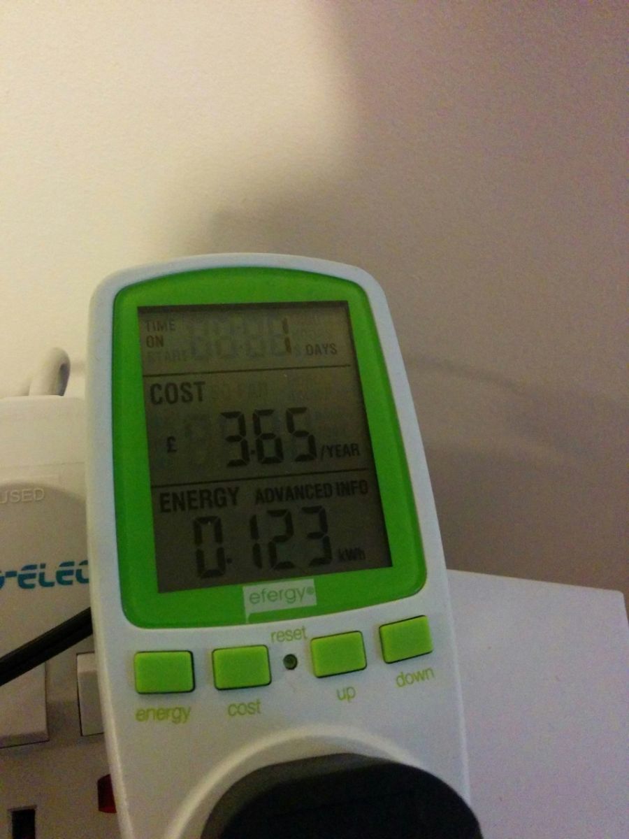

Initial power consumption results using the converted freezer on a mains watt-meter
When running; the freezer’s compressor draws around 52-watts average [with a 659W max peak].
Over 24-hours it consumed only 0.123KwH!
This worked out that the converted freezer was on only 10% of the time or around 5 - 6 mins for every hour.
This was with the freezer [now acting fridge] half-full of food, pre-run down to temperature before readings began, the door never being opened and within a 21° environment all day
The quoted yearly consumption on the standard LEC freezer is 146KwH per year. As a converted fridge with the external thermostat set to 4°C it now only uses 45KwH in a year!

The mains watt-meter must also be factored-in as that itself had a constant power draw of 2 Watts.
I also measured the 12V power consumption of the digital control relay [which was running off a separate 12V power supply] separately using a multi-meter and found it drew around 0.1 Amps or 1-watt constantly.
When you also factor-in the 0.4-Watt hourly draw of the inverter in its standby mode I could count the 0.123KwH reading as including both the temperature relay controller and the Inverter by subtracting the watt-meter’s 2-watt constant consumption.
This means the total setup on a warm day uses around 11AH in 24 Horus!
Even when factoring in that the Inverter might only be 80% efficient when running, that is still a total battery consumption of no more than 12-13AH in a day. Suck-it 12V fridges.

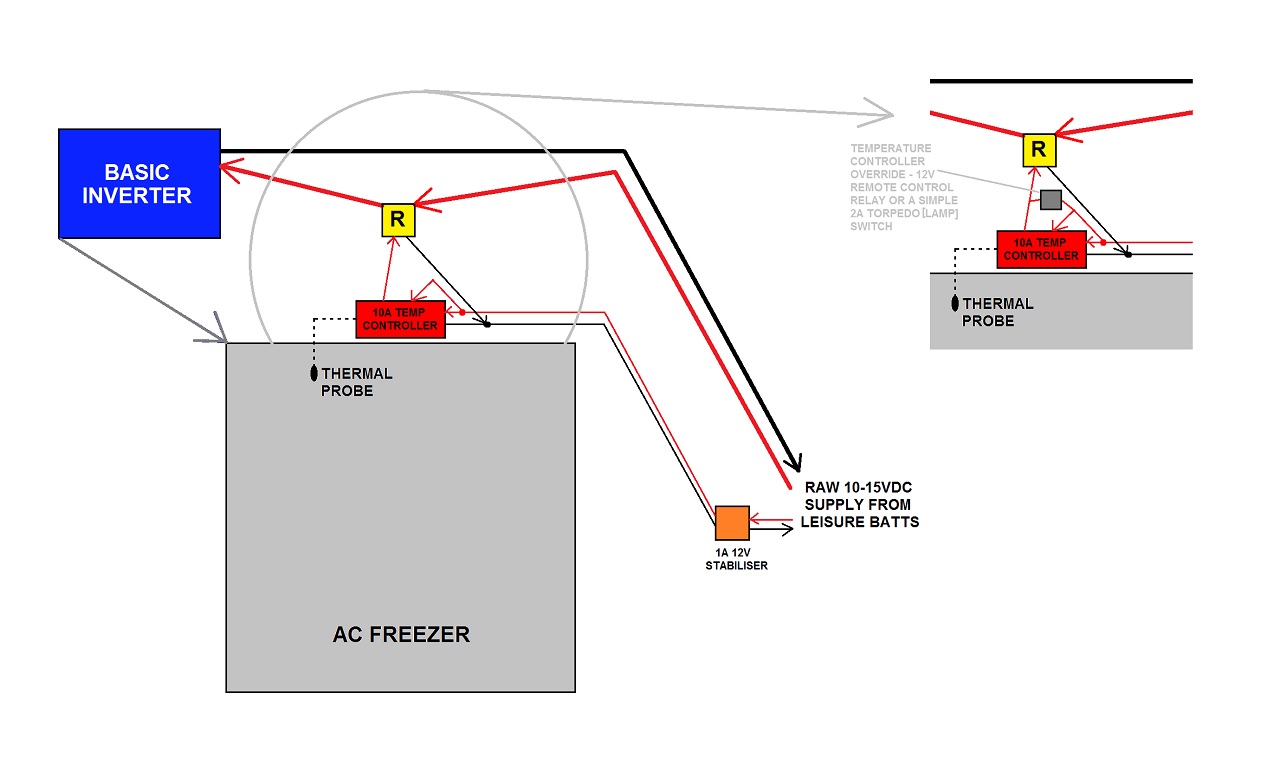

Making the setup even more efficient using a simpler [& cheaper] inverter using a 2nd heavy-duty [high-amp] relay and an optional bypass switch or a third [remote-controlled] relay.
Instead of using an expensive Inverter with a low-standby current like the TBS [or a Victron Phoenix 800]; another method I’ve thought of is using the digital temperature controller to instead switch on & off another high-amp relay connected in-line to the Inverter’s DC power input cable instead of the fridges AC power.
This means that instead of the inverter being on all the time with its parasitic standby current, the temperature controller can send a command to the heavy-duty relay to switch on the inverter on-demand.
All this would leave is the focus on getting something that is reasonably efficient at its DC-AC conversion but without the worry that it has a high standby current .
Something like a cheaper Sterling 800W Quasi Inverter or a Chinese Pure-Sine Inverter that is rated to at least 700W+ for around £120 should do the job here for much less than a 12V fridge.
As a final bonus to this setup; a 12V remote control activated bypass relay could be fitted between the temperature controllers 12V switched input and the heavy-duty relays switched input to allow the inverter to be switched on independently of the temperature controllers demand so it can be briefly used for other short-term uses such as running a small twin-tub washing machine, a travel Iron or hair straighteners.
It would have to be brief use items as eventually the inverter will have to go back on fridge duty.

Here is a list of items required to set-up an efficient AC system using any common inverter
· <£100 - Currys Essentials 60L Chest Freezer [as an example!] You could buy any freezer but if you can fit a chest-type in your boat, it is better for efficiency.
This model for example uses 153Kwh and based on my results above, should drop consumption running as a fridge by about a factor of 3.2 so should only require 48KwH in a year running at 4°C.
This breaks down into 132-watts [or 11AH] daily. Bump this figure up to around 13-14AH per day based off of an 80% efficient Inverter.
· £113 – Sterling Pro Power Q [quasi-sinewave] 12V Inverter [uK based company support with a reasonable brand image compared to a unknown Chinese suppliers] – This should run most things including small power tools except induction items like cordless rechargeable electric toothbrushes.
· £21 – Durite 120-Amp heavy-duty relay [P/N: 0-727-18] - This isn’t needed if you can rewire the on-off toggle switch of the inverter itself directly to the digital temperature controller.
Otherwise; this gets installed in-line to the Inverters positive DC power input cable. The Inverter’s toggle switch must be left in it’s on position.
The secondary terminals on this heavy-duty relay are controlled by the digital temperature controller [or via a bypass switch when operating other items].
· £8 – MH1210A 12V Powered Digital Temperature Controller [relay]
· £4 - REUK 0.8Amp 12V voltage regulator [this is needed so that the digital temperature controller isn’t fried when your leisure batteries are being charged at 15V+ on a cold day]
· £2 - Torpedo [temperature controller bypass] switch = £2 or……. a remote control 12V relay = £18]
With this setup, the unmodified domestic freezer is simply plugged into the inverter.
The total cost for this system is around £250 which is half that of your average new 12V fridge but this includes both an easily replaceable domestic freezer [fridge] which itself doesn’t need to be physically modified and you gain the benefit of an inverter on-board for some extra luxuries.
Re-housing your old 12V compressor would cost about the same as this setup but keeping it as a fridge in a fridge-style cabinet would use more power. Just look at the Amp-hour figures quoted by Shoreline and Waeco on their fridges.

Oh dear (in reply to post #22) - I thought your figure was an actual measurement taken from the efergy socket meter, rather than a reasoned guess.Not a criticism, but I've seen all sorts of figures bandied abut here and elsewhere. Danfoss give a peak draw for their DC units but zilch for the A/C types.
The Efergy is no longer available and there have been no s/h units on fleabay since June. There are other units around but a bit vague - 'overload power' is mentioned by one - but what is meant by 'overload'. Given that the peak power draw occurs for a 'few' milliseconds, I doubt whether the unit is sufficiently sensitive - quick acting - to capture that amount.
