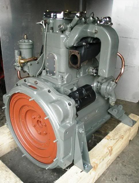

Would appreciate a bit of help/experiences of the following problem. My engine is now fully installed and was started up for the first time this week. All is well except that sometimes when I turn the key I get a single click (in fact more often than not from cold, although its only been started about 10 times from installation. I have asked a member on here via email and he kindly came back along the lines as follows. He said
"What’s happening is that the clearances between the ring gear and the starter pinion are still very tight, the bearing on the pinion is probably still tight and the edges are still sharp. So if they teeth on the two line up exactly just by accident when the engine stops the pinion is blocked. Sometimes trying it a couple more times will get it into mesh and sometimes just turning the engine slightly will do it"
I have turned the key on and off up to a dozen times and sometimes it starts after 2 or 3 turns of key. While there is no pulley guard on, I can indeed move the pulley a little to turn the engine and this fixes it but I wont be able to get at the pulley once the guard is installed. Anything I can do?

I took the starter off then put it back on with one spring washer per bolt to offset it by the thickness of the washer. This has now solved the problem and it turns over each turn of the key.

Charles, just for future reference you have a pre engaged type starter in this case made by Bosch. I urge you to have an appropriate spacer made for your starter, if you leave it with washers as spacers then this will over time fret and damage both bolts and starter flange, bolts are not made to be stressed that way. If you aim for a clearance of 6mm between starter pinion and ring gear you will not be far wrong.

From the picture I would say it's genuine, 300 series I think.
