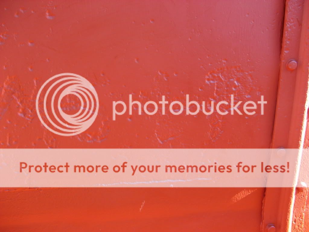

Chertsey Posted May 25, 2010 Report Posted May 25, 2010 Whilst putting another coat of paint on Chertsey's hold last week, Jim noticed this for the first time - ghostly writing corroded into the steel (that bit's original). It looks to me as if something has been painted on there and caused a different pattern of corrosion under the paint - would that be a sensible guess? It looks like it says M S + P. So, has anyone seen this sort of thing before, and can you cast any light on who, what, when, where, why?
carlt Posted May 25, 2010 Report Posted May 25, 2010 Apparently they mark all the luxury yachts, they sell ... Clicky
Steve Priest Posted May 25, 2010 Report Posted May 25, 2010 Harland and Wolff would paint reference marks on plates as they were cut and prepared, so that the platers would know which plate went where as they plated the boats up. They quite often come to light when boats are stripped back to bare metal, and are normally quite easy to read, but I've not seen any cause pitting like that before. I would think that MS + P means plate M, starboard and port
Chertsey Posted May 26, 2010 Author Report Posted May 26, 2010 Thank you Steve, I'm chuffed to know it goes back that far.

Chertsey Posted May 28, 2010 Author Report Posted May 28, 2010 It stands for 'More Sanding and Preparation' Oh no!!
twbm Posted May 29, 2010 Report Posted May 29, 2010 It stands for 'More Sanding and Preparation' Having spent four days wire brushing, sanding and rubbing down Brightons cabin sides, imagine my delight when the first gloss coat revealed the old signwriting glimmering through in the right light. D'OH. When I do Nuneaton I may cut the steel out to be sure .....
Max Sinclair Posted May 29, 2010 Report Posted May 29, 2010 Whilst putting another coat of paint on Chertsey's hold last week, Jim noticed this for the first time - ghostly writing corroded into the steel (that bit's original). It looks to me as if something has been painted on there and caused a different pattern of corrosion under the paint - would that be a sensible guess? It looks like it says M S + P. So, has anyone seen this sort of thing before, and can you cast any light on who, what, when, where, why? When I stripped off Vestas steel engine room exterior I found all the original lettering and paint decoration stood slightly proud giving me the name and number details.

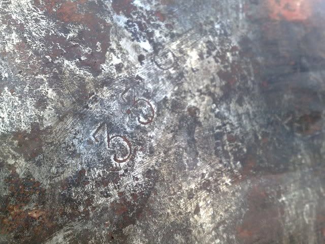

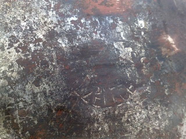

mykaskin Posted June 1, 2010 Report Posted June 1, 2010 (edited) When Victoria was back to her nothings for painting, some steel makers marks could be seen: Copper content percentage? Product stamp? She was made from "Coppered Steel" - why would this be better than "normal" steel? Would it help in a salty marine environment, though a Google search doesn't give any clues. Cheers - and sorry for any thread highjacking, just thought it would be interesting to show the pictures, Mike Edited June 1, 2010 by mykaskin
