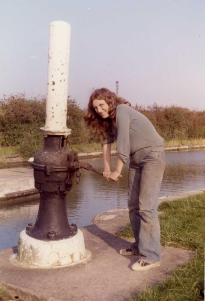

Derek R. Posted February 15, 2015 Report Posted February 15, 2015 Nice to see the 'innards'. I have often wondered what the broken off lug was for, does anyone know it's original purpose? Considering the fact that some do drop quite quickly, might there have been an external brake pivoting at the lug? I've wound down a few, and used my hand as a clutch on some, though that can hurt if they want to drop fast.
OldGoat Posted February 15, 2015 Report Posted February 15, 2015 On 15/02/2015 at 15:22, Derek R. said: Nice to see the 'innards'. I have often wondered what the broken off lug was for, does anyone know it's original purpose? Considering the fact that some do drop quite quickly, might there have been an external brake pivoting at the lug? I've wound down a few, and used my hand as a clutch on some, though that can hurt if they want to drop fast. There use to be an U-shaped block attached with a chain to that lug, so that you could lock the gear in an up position while the lock was filling. BW removed them and cut the top of the lug off - presumably to stop anyone 'repairing' the fixture. I don't know if that was because of Elfin safety or mebe 'cos some folks (repeatedly) left the sluices up when going downhill (- Oh, yes it does happen) thus emptying the pound or possibly the flight. I can remember the blocks in place - so it must be post privatization (haha). I was told - quite strongly - by BW staff that the paddles should be (must be) wound down - Yeah...
David Schweizer Posted February 15, 2015 Report Posted February 15, 2015 (edited) On 15/02/2015 at 15:54, OldGoat said: There use to be an U-shaped block attached with a chain to that lug, so that you could lock the gear in an up position while the lock was filling. BW removed them and cut the top of the lug off - presumably to stop anyone 'repairing' the fixture. I don't know if that was because of Elfin safety or mebe 'cos some folks (repeatedly) left the sluices up when going downhill (- Oh, yes it does happen) thus emptying the pound or possibly the flight. I can remember the blocks in place - so it must be post privatization (haha). I was told - quite strongly - by BW staff that the paddles should be (must be) wound down - Yeah... They were missing fifteen (and possibly more) years ago, In fact I cannot remember them even back in the 1960's, so they were perhaps removed post Nationalization! Edited February 15, 2015 by David Schweizer

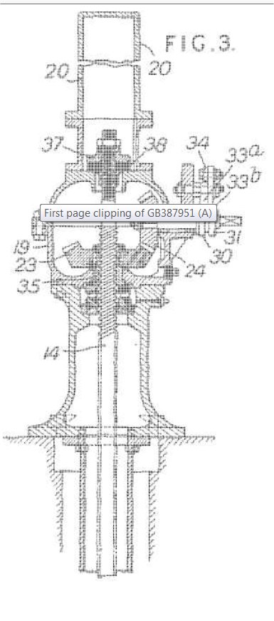

pearley Posted February 15, 2015 Report Posted February 15, 2015 (edited) The cutaway drawing in Laurence's thread shows something secured to that block with a but and bolt arrangement. Possibly a cutout that swivelled over to lock the gear? Edited to add that I should have read the link Laurence attached. It states that a ratchet pawl is mounted on that bit just behind the windlass slindle. When I've looked at them I got the impression that the castings had broken there rather than being cut off. Edited February 15, 2015 by pearley
alan_fincher Posted February 15, 2015 Report Posted February 15, 2015 On 15/02/2015 at 17:09, pearley said: The cutaway drawing in Laurence's thread shows something secured to that block with a but and bolt arrangement. Possibly a cutout that swivelled over to lock the gear? Edited to add that I should have read the link Laurence attached. It states that a ratchet pawl is mounted on that bit just behind the windlass slindle. When I've looked at them I got the impression that the castings had broken there rather than being cut off. This has been discussed in a previous thread, I know. Some of the gear at Calcutt still carries parts that I cannot recall as still present at any other locations. (Or at least it did the last time I was there, which probably isn't that recently now.).
Derek R. Posted February 15, 2015 Report Posted February 15, 2015 (edited) On 15/02/2015 at 17:09, pearley said: The cutaway drawing in Laurence's thread shows something secured to that block with a but and bolt arrangement. Possibly a cutout that swivelled over to lock the gear? Edited to add that I should have read the link Laurence attached. It states that a ratchet pawl is mounted on that bit just behind the windlass slindle. When I've looked at them I got the impression that the castings had broken there rather than being cut off. The idea that there might have been a pivoting device with 'U' shaped piece locking over the larger of the two square bosses seems most likely, and I can imagine the castings getting stressed to breaking point - hence the replacement with a 'U' shape on a chain. Last time I went that way all had a chain and locking device. No other way they would stay up without hanging on to the windlass. Ah! A ratchet! Don't recall seeing that before. Eyes wide shut. Edited February 15, 2015 by Derek R.
X Alan W Posted February 16, 2015 Report Posted February 16, 2015 On 15/02/2015 at 16:44, David Schweizer said: They were missing fifteen (and possibly more) years ago, In fact I cannot remember them even back in the 1960's, so they were perhaps removed post Nationalization! Hatton still had some in the early /mid 60's it seemed that if the crowfoot locking bit wore to the point of may/not hold they removed them, also if the chain broke same thing, I remember a BW guy cutting off the lug with a hacksaw on one of the flight
Laurence Hogg Posted February 16, 2015 Report Posted February 16, 2015 On 16/02/2015 at 08:42, X Alan W said: Hatton still had some in the early /mid 60's it seemed that if the crowfoot locking bit wore to the point of may/not hold they removed them, also if the chain broke same thing, I remember a BW guy cutting off the lug with a hacksaw on one of the flightOn the drawing it was part 34 which pivoted and locked the spindle, many got broken and very few were left by the 1970's, I doubt any survive today.
David Schweizer Posted February 16, 2015 Report Posted February 16, 2015 On 16/02/2015 at 08:42, X Alan W said: On 15/02/2015 at 16:44, David Schweizer said: They were missing fifteen (and possibly more) years ago, In fact I cannot remember them even back in the 1960's, so they were perhaps removed post Nationalization! Hatton still had some in the early /mid 60's it seemed that if the crowfoot locking bit wore to the point of may/not hold they removed them, also if the chain broke same thing, I remember a BW guy cutting off the lug with a hacksaw on one of the flight The first time I went up Hatton was 1967, so my recollection is probioby correct.
Derek R. Posted February 16, 2015 Report Posted February 16, 2015 (edited) Where's this drawing from Laurence's attached link? The only things I see are the companies modern day products. The claws were there in 1988. (Hanging on chains). Edited February 16, 2015 by Derek R.

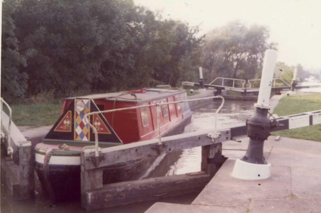

alan_fincher Posted February 16, 2015 Report Posted February 16, 2015 On 16/02/2015 at 11:53, Derek R. said: The claws were there in 1988. (Hanging on chains). I'm pretty confident that in the early 1970s, the only option on any was the "claw on chain". What I do think was different, is that a great deal of them back then didn't have the indicator rod added. I would suggest that in the days when traffic was all working boats, and few or no leisure craft the indicator rods would have served little purpose, because paddles were generally left up on the exit gates, so the next crew along would assume them to be up, and dropping them before the lock was worked would normally have been required every time. These pictures, I think 1973, show the claws (just). My first wife Pam on the paddle...... The boat was my first one, and allegedly 1898 build, though that may not be accurate
Laurence Hogg Posted February 16, 2015 Report Posted February 16, 2015 On 16/02/2015 at 11:53, Derek R. said: Where's this drawing from Laurence's attached link? The only things I see are the companies modern day products. The claws were there in 1988. (Hanging on chains).
rrt2 Posted February 17, 2015 Report Posted February 17, 2015 (edited) Looking at the drawing then I would think that the original way to hold the paddles up was a basic rachet and pawl mechanism. Part number 33b being the pawl ( still in place on the paddle gear). Part number 33a the ratchet arm Part number 34 the ratchet pivot bolt not numbered on the drawing but the through bolt assemble just beloe the notation 3b would have been bolted to the now broken part. This is the ratchet arm stop as well. Part numbers 30 and 31 were these guide plates with the ratchet arm sitting between them Edited February 17, 2015 by barry adams

Laurence Hogg Posted June 19, 2015 Report Posted June 19, 2015 On 17/02/2015 at 10:51, barry adams said: Looking at the drawing then I would think that the original way to hold the paddles up was a basic rachet and pawl mechanism. Part number 33b being the pawl ( still in place on the paddle gear). Part number 33a the ratchet arm Part number 34 the ratchet pivot bolt not numbered on the drawing but the through bolt assemble just beloe the notation 3b would have been bolted to the now broken part. This is the ratchet arm stop as well. Part numbers 30 and 31 were these guide plates with the ratchet arm sitting between them No, it was a part that pivoted onto the square section effectively locking it, you then pulled it off and let the paddle fall, there were a few in place in the 1970's but the inherent weakness was the pivot which is often seen today as a fractured casting part.
john6767 Posted June 19, 2015 Report Posted June 19, 2015 On 19/06/2015 at 20:45, Laurence Hogg said: No, it was a part that pivoted onto the square section effectively locking it, you then pulled it off and let the paddle fall, there were a few in place in the 1970's but the inherent weakness was the pivot which is often seen today as a fractured casting part. I thought they had been smash off to remove them, did not realise that the castings failed, is it that failure that cause them to be removed and replaced by the claw
Laurence Hogg Posted June 19, 2015 Report Posted June 19, 2015 On 19/06/2015 at 21:15, john6767 said: I thought they had been smash off to remove them, did not realise that the castings failed, is it that failure that cause them to be removed and replaced by the claw Spot on John, that's where the claws came from as I was led to understand.
