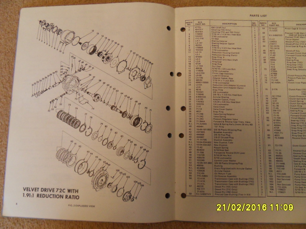

  1. Hi Moved house see my Kelvin post, came across this, hope the attachments work, gave up with Photobucket after more freezing and crashes (took ages to get pic on Kelvin post, rant over. Its Borg Warner Velvet Drive Reduction box service manual if the pic's work all the info can be seen. I had it well over 30 years ago so must fall in the "vintage cat". It's free just postage to anyone who would like it hence not in the for sale forum and I want the old engine boys to have first chance. regards david I see the pic's are OK
