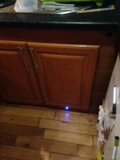

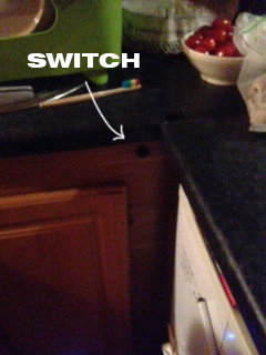

  2. So, as the title suggests. I have a really weird problem. There are these two LED lights in my kitchen, foot level, that I have tried (Numerous times) to turn on and they never have! I thought they were for decoration, but now I'm worried they are a warning light. They are somehow to do with the 12v system as there's a switch (That turns our water pump on) under the drainage area which also turns this light off. The light suddenly turned on the other day and keeps occasionally turning on. It's now on permanently... The other one, to the left of it, is not on still. So I have no idea what that is for either! I have attached pics for reference. Any help would be greatly appreciated. Thanks, Jamie (On WALT)
